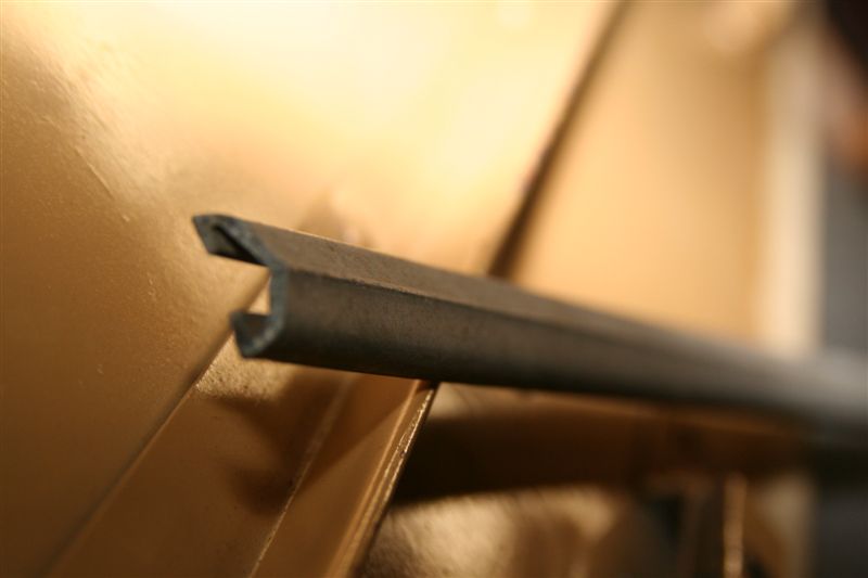

New info and new research on this subject:
All Beeskow-models used a special extruded aluminium profile for side moulding trim. Very very few cars have survived with this intact, as a matter of fact I do not of any with all six pieces intact. (Eric?)
Below is the picture of the original door trim from car number 200. Nice profile - this is the angular cut at the back of the door. The front end (I will picture and post) is a straight cut AND it is indeed welded/filled and "end-finished". Makes sense - as the front of this moulding is very visible when you open the door.
So - with this original piece now in hand - The Rometsch Beeskow Registry will embark on another reproduction excecise. We will assume all owners of the 31 survivors will want/need a set (?). These will be straight and unfinished but we have found an excellent source for the right bolts/clips/plates that hold them to the car. Price and availability will follow....but it is now initiated with this original masterpiece in hand. Thanks again Mr Grundmann!
Please send an email to "[email protected]" to confirm interest. Any and all comments on this topic is also appreicated.
